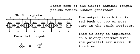

Faster, shorter method.
The above pseudo random number generator is known as a Fibonacci generator and, while it works, it turns out there is a much better generator to implement with a microprocessor.
Galois pseudo random sequence generator.
The Galois generator needs only to test the state of one bit and that can be tested after the shift has been performed. The state of this bit determines whether the feedback term is exclusive ORed with the result. This single bit test and multiple bit feedback is easily done as can be seen from the code below.

You don't have to limit the length to only 8 bits, any number of bits from three upwards will work if you chose the right feedback value. Here is a table of some values that have been chosen to give a feedback value that fits in a byte, this makes implementation on an 8 bit micro as short as possible. For these values bit n is the least significant bit in the value and the tested bit is the bit shifted out from bit 1.
