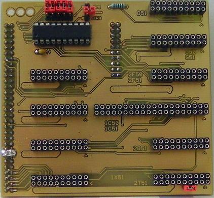

1X51 backplane:
This module is used in the X50 and X51 project.
Because register addresses for both projects are different,
we have to compensate this with a few jumpers in the left upper area
of the PCB.
Also, there is a three pin jumper for connecting the interupt output
either with NMI or IRQ.
The jumper in the right lower area enables the blinkenlights.
