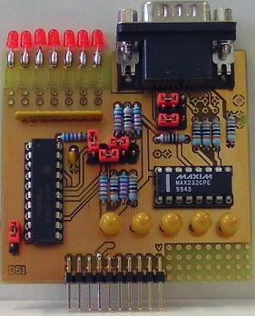

D51 RS232 level converter module
RS232 to TTL and back level converter.
Concept and jumper field are stolen from Daryl's SBC-2.
This module is used in the X50 and X51 project.

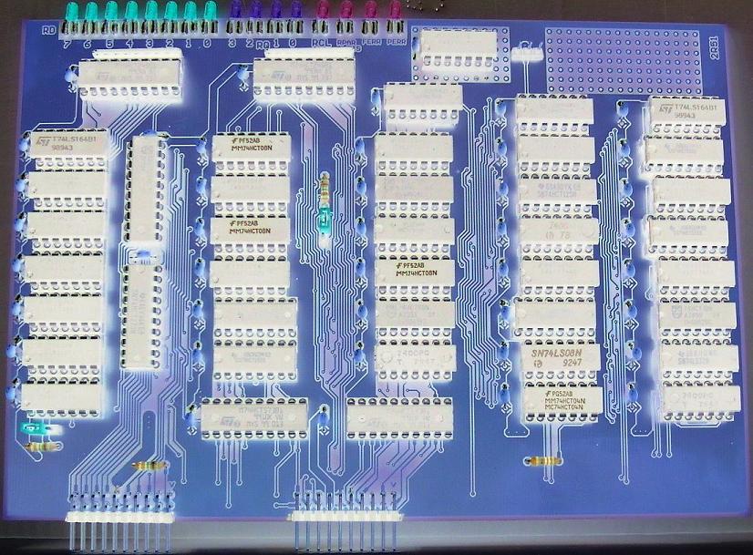

2R51 receiver module
That's the part which horribly failed,
and which isn't in the project files.
Unfortunately, this module is used in the X50 and X51 project.

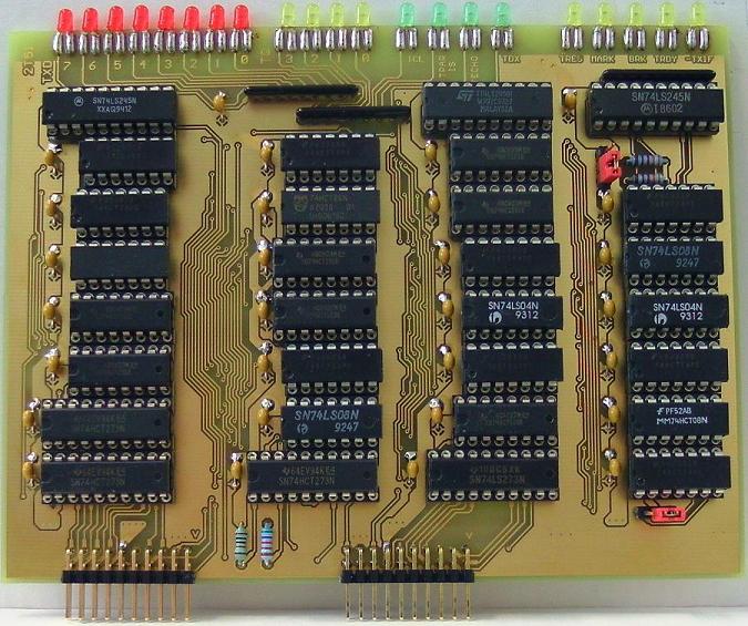

2T51 transmitter module
Parallel to serial converter...
