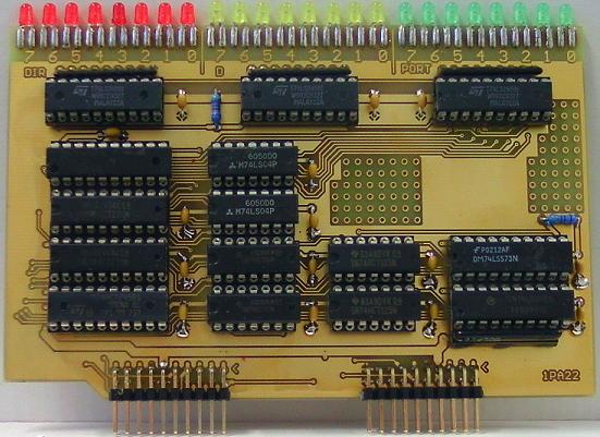

1PA22 Port A module
Port A has open collector outputs.
There is a pullup resistor network for the port lines
in the schematic and layout of the port lines.
I suggest to solder a single row precision socket into the PCB,
to make sure that you are able to try different resistor values,
or to go without pullup resistors if necessary.

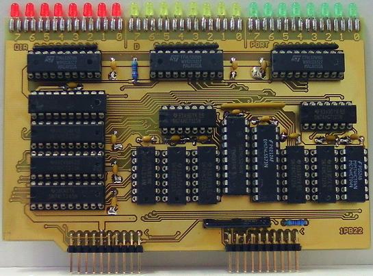

1PB22 Port B module
Port B has three state outputs.
BTW: Port A module and Port B module have identical pinouts.
