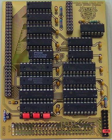

2B22 bus interface
The jumper field in the lower right area is for the chip select.
The bus interface is from the X22 project (6522),
what means that it decodes A0..A3.
Unlike the 6522, the 6523 doesn't have 16 registers,
so for better compatibility it's possible to deactivate
the unused address lines with the three jumpers
in the lower left area of the PCB.

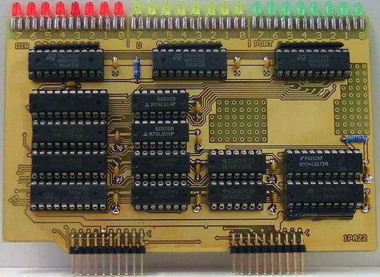

1PA22 Port A module
Port A has open collector outputs.
There is a pullup resistor network for the port lines
in the schematic and layout of the port lines.
I suggest to solder a single row precision socket into the PCB,
to make sure that you are able to try different resistor values,
or to go without pullup resistors if necessary.

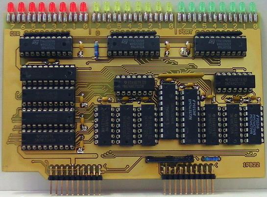

1PB22 Port B module
Port B has three state outputs.
BTW: Port A module and Port B module have identical pinouts.
