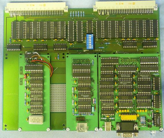

Peripheral/IO PCB.
Three modules can be plugged on top, and three modules at the bottom.
Currently, we have a timer, a PC keyboard interface, and a TTL UART.
The timer had some minor bugs, but they are fixed in the new PCB layout.

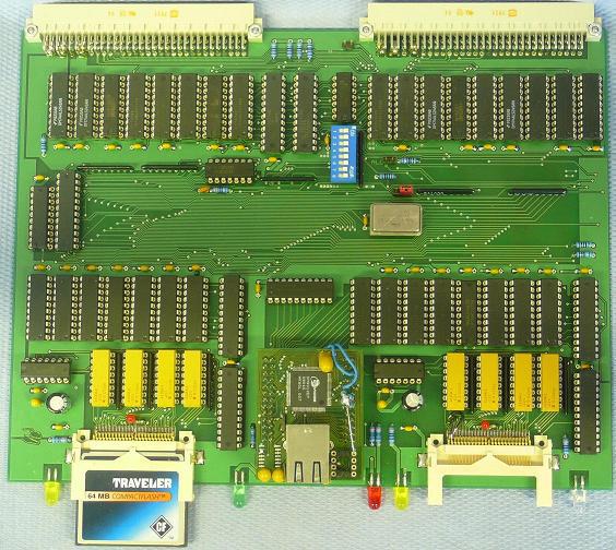

Ethernet and CompactFlash.
It would have been interesting to build a TTL based Ethernet controller,
but because it would have had only 10 MBit (and we already had enough other
important work to do), we decided against it.
Unfortunately, the DM9000 went out of production, and we had to modify
our design a little bit to go with the DM9010.

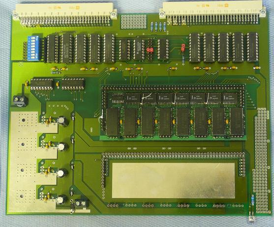

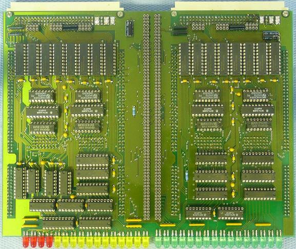

Memory PCB.
Note the little module plugged on top of the PCB.
It's a 4 layer PCB, with 8 SRAMS (512 kB each) on top, and 8 SRAMs at the
bottom. It's possible to plug up to 16 such modules into the big PCB,
which means two stacks (4 modules each) on top of the big PCB,
and 4 modules at the bottom.
Since one module carries 16 RAMs 512 kB each, the module has 8 MB RAM,
and the big PCB would be able to carry 128 MB of 15 ns SRAM in total.
Enough for running serious software...
Note: when defining one layer of a multilayer PCB as GND, make sure
that the PCB manufacturer _really_ knows about this,
else use GND polygons in the PCB layout.
The design also contains PCB space for four 3.3V regulators,
just in case that 5V SRAMs might go out of production.

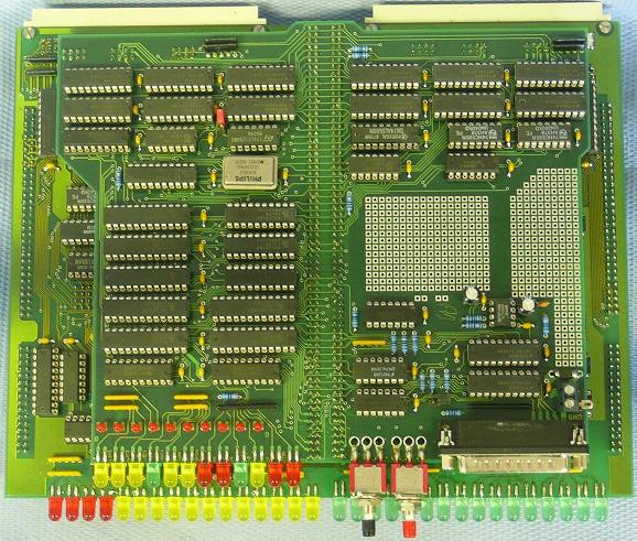

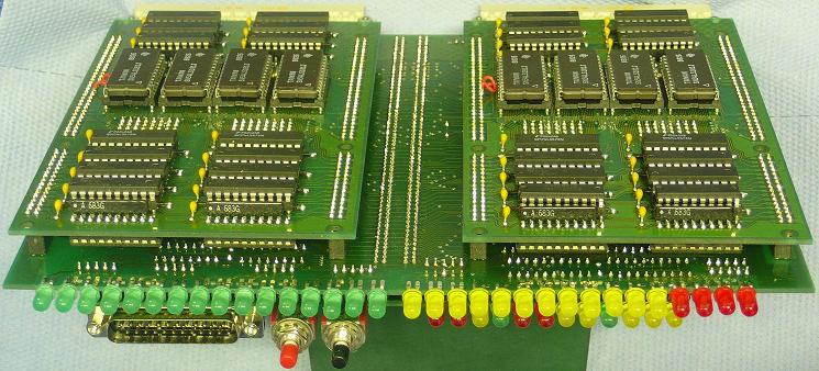

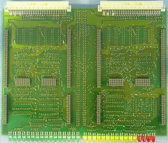

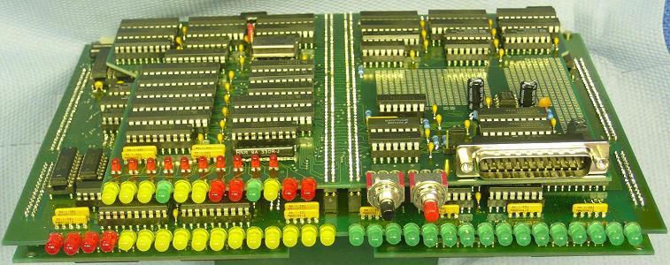

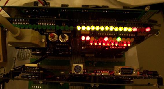

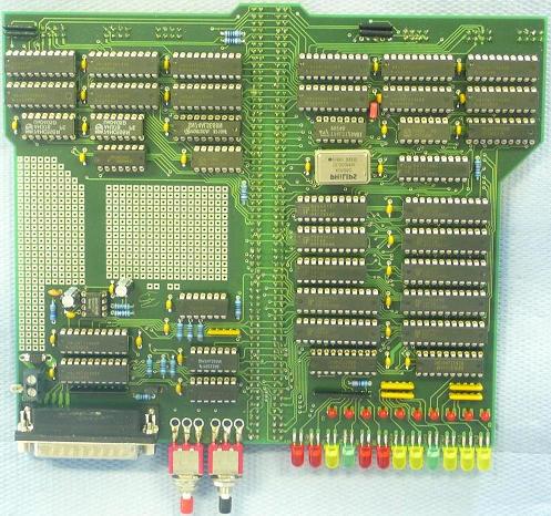

Now for the CPU.
Some pictures from top, bottom, and the side.
The CPU is a neat, compact "sandwich".
The big PCB in the middle of said "sandwich" contains the bus interface
and the status register.
A closer view of the big PCB, note the "high density" connectors.

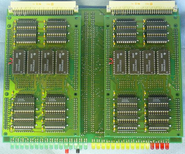

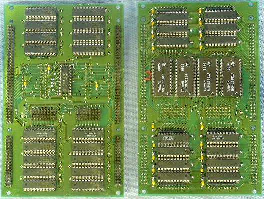

Three smaller PCBs are plugged into this big PCB:
The control PCB with the instruction latch/decoder/sequencer has 4 layers,
and contains quite a few GALs.
The other two PCBs carry 7 registers (biport register file built with 74574),
a shifter, and a 74181 based ALU.
Since each of the two identical PCBs/modules carries ALU and registers
for only 16 Bit, two modules are required for a 32 Bit CPU.
Note the ICs on top and at the bottom of the PCB.
Yep, 37 ICs in total (four of them DIP24) on a two layer PCB. :-)
The hard_to_buy 74182 can be replaced by a GAL if necessary.
The "TTAP port" of the CPU can be connected to the LPT port of a PC,
basically it's sort of a simplified JTAG interface, so it's possible to
start/stop/single_step a program, to execute an instruction sent by the
PC, and to read/write CPU registers...
which makes it possible to read/write CPU memory.

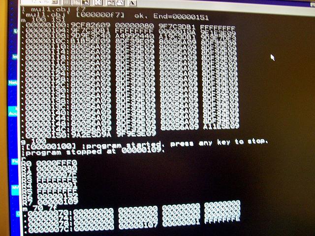

Here a screenshot of a test program, doing an unsigned 32 * 32 Bit
multiplication with a 64 Bit result.
So 0xffffffff * 0xffffffff = 0xfffffffe00000001, and the program worked.
