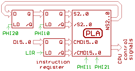

Now a very simplified diagram, how the logic block (build with 5 PLAs)
is connected:
We happen to have a three Bit state machine, with S0..2
as the current state and NS0..2 as the next/following state.
Note the master/slave_flipflops, loaded with two non_overlapping
clock signals:
PHI20, PHI10.
Three Bits in a master/slave configuration means six flipflops.
Note, that the outputs (inverted and non_inverted) of the slave
flipflop are connected to PLA inputs, because our PLA modules
don't have integrated inverters, like PALs/GALs.
Additionally, we also have the 16 Bit OpCode, loaded at the
beginning
of the instruction execution with LIR into
the instruction register.
This also may be a source of information to the PLA, what to do,
and what step to take next.
Like performing calculations for a given addressing mode,
for instance.
Some PLA outputs, that control load/clock_signals for some
other registers/flipflops
(like the LIR signal), are gated
inside the PLA by two clock signals:
PHI11 and PHI21.
To be on the safe side, I decided to buffer those PLA outputs
with four 74HCT245 (the only TTL ICs inside MT15).
I know, that clock gating is evil, but it doesn't take
much transistors.

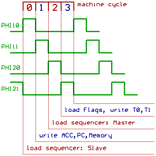

To clarify things, we take a short look at the clock signals,
already mentioned in my previous article:
The MT15 architecture.
