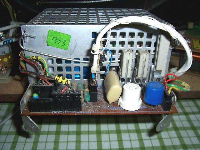

As the mains switch went defective, I started to
wonder if it would be possible to replace it by a
more reliable solution.

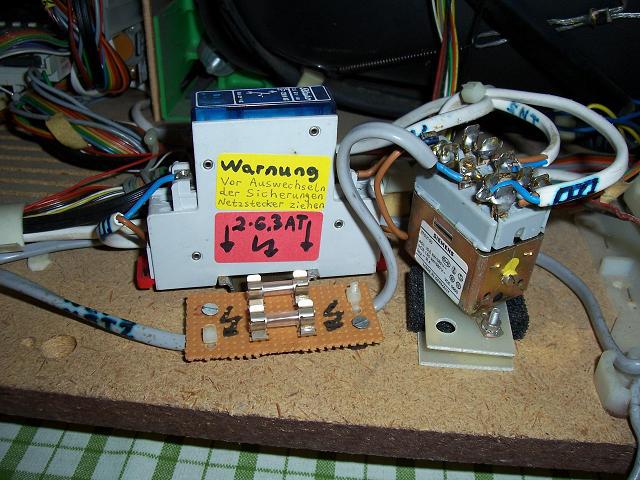

First, I did replace the switch with a "pushbutton"
like those used in control cabinets...
(The brown thing at the left side of the picture.)
It triggered an "Eltako", as used in staircase
illuminations, which turned on/off a neat contactor
(at the right side of the picture).
Note the PCB material below the contactor:
A homebuilt "silencer" to prevent the casing of
the TV from humming at 50 Hz.
Two switches 16A were wired in parallel, to make
the contactor live longer than than the rest of the TV.

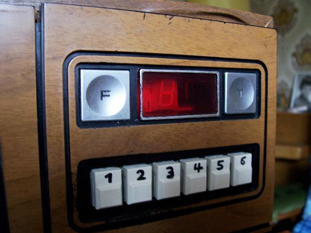

Unfortunately the TV did have sensor buttons to change
the cannels, things that sense the impedance of the
tip of your finger... and after two decades of operation,
cleaning solvent didn't help anymore to keep them
working.

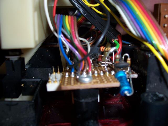

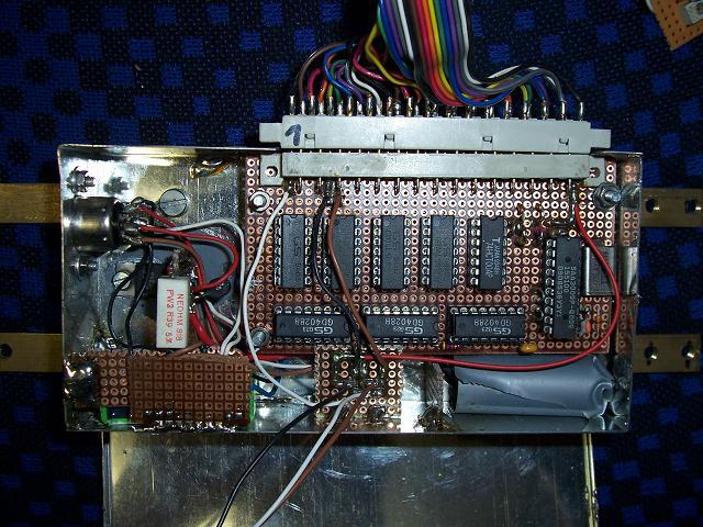

Also, the Nixie tube in the display did fail to show
all of the numbers, so I did decide to build something
more reliable.
Middle: precision DIP socket, holding a 7 segment display.
Right: receiver for an IR remote control...

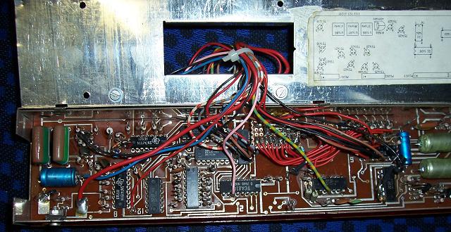

The ICs related to said sensors also did show some
signs of oxidation/corrosion, so I just did replace that
part of the circuitry with some CMOS logic ICs from
the drawer.
Some Schmitt triggers, a priority encoder, a latch,
then a decoder and some transistors to drive the reed
relays (not shown in this picture), which sent different
voltages to the tuner.
Did have no 7 segment decoder/driver IC in the drawer,
so I did use a handful 1N4148 diodes instead.

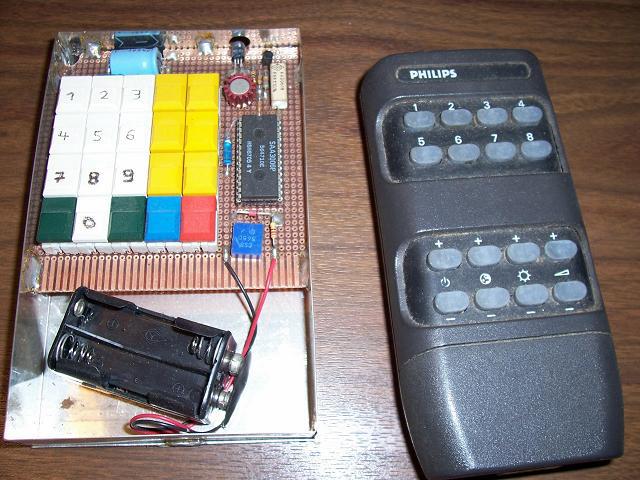

The ultrasonic remote control of the TV went
defective, maybe because of leaking battery acid...
Buying a replacement for the remote control did turn
out to be very expensive, so I did decide to build my
very own IR remote control.
Ok, so it won't win a price for beauty, on the other
hand it won't be impressed when getting thrown at a
brick wall.

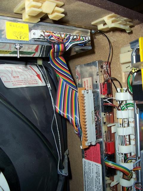

Problem was, the TV did have no microcontroller at all,
and for some reasons I wanted to keep it that way.
Right side: original Philips ultrasonic control
circuitry. The metal box did have a sign on it:
"If the TV happens to do anything strange, replace
the whole box with another box from the factory.
Thou shalt not try to repair it by yourself."
As a hobbyist, you can't resist such labels.
Figured out, that they did use 74xx up/down counters
with DACs built from simple resistor networks to set
volume, brightness and such.
And I happen to know, what to do with 74xx ICs...

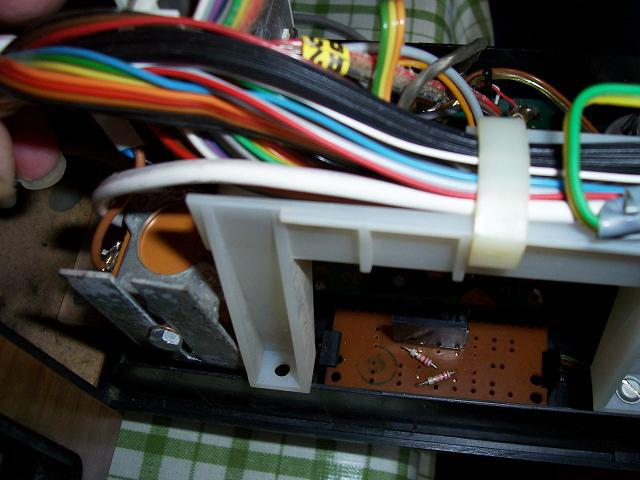

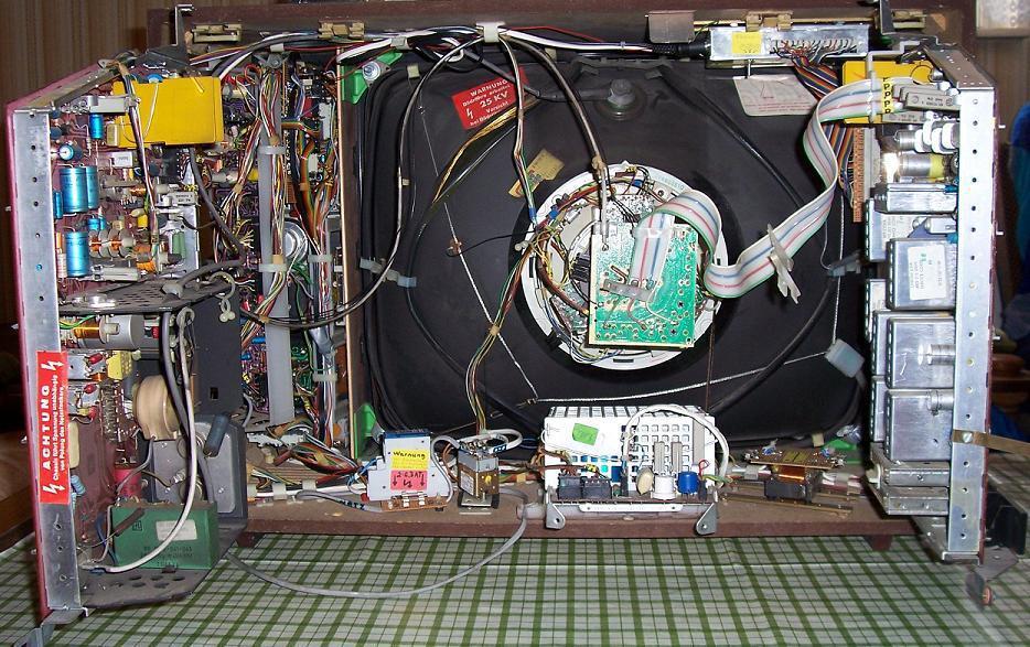

At some point, I did want to have a standby
mode, so I did a few more modifications.
Here the switchmode power supply, with a cable
which wasn't intended to be there by the manufacturer.
And a transformer with a 9V output, which powered
the control circuitry during standby.
But in the end, it did feel too much like riding a
dead horse.
As it went defective again, I didn't want to fix it
anymore, so the TV went scrapped back in 2007.
