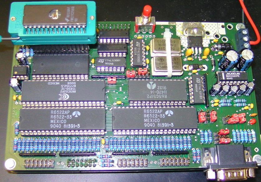

2013: After nearly 5 years of absence from hobby electronics,
I built a 6502 single board computer for getting started again.
So please don't complain if things look less clean
than in my old/previous projects.

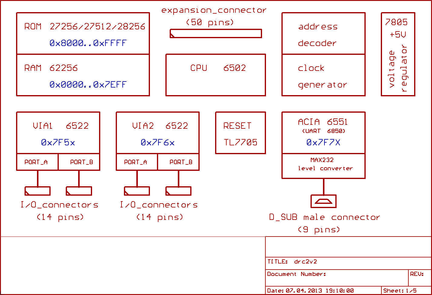

DRC2 is (more or less) based on Daryl Rictor's SBC2.
// I just like the elegance/simplicity of the SBC2 concept.
CPU:        Pin 1 of the 6502 can be connected to GND with a jumper,
            so it's  possible to use a WDC 6502 and non_WDC 6502.
Memory map: I'm using the same address decoder as the SBC2.
            $0000..$7EFF RAM
            $7F50..$7F5F first  6522
            $7F60..$7F6F second 6522
            $7F70..$7F7F 6551 (alternatively 6850)
            $8000..$FFFF ROM
RAM:        32 kB RAM... minus the I/O space.
ROM:        always 32 kB.
            27256 EPROM, 28256 FLASH...
            or a 27512 EPROM with the upper or lower half of it's 64 kB
            mapped to CPU memory, depending on the jumper setting.
I/O:        2 * 6522, 1* 6551.
            9 pin male SUB_D connector for RS232.
            The pinout for I/O connectors and bus expansion connectors
            is supposed to be compatible to the SBC2.
            To be on the safe side, I inserted 100 Ohm resistors
            between the 6522 I/O pins and the I/O connectors.
            Interrupt signals from the 6522s and the 6551 are ANDed
            together by using a 7421, so it's possible to use ICs from WDC
            (which have a push/pull output) and ICs from other vendors
            (which have open collector output).
Reset:	    TL7705.
            It isn't the best reset IC out there, because it is sensitive
            to spikes in the power supply, and it probably won't work well
            if VCC is below 3.6V...
            but I had some of those ICs in the drawer.
Clock:      Two TTL metal can oscillators, plus a 74393
            and some jumpers for dividing down the oscillator outputs:
            16 MHz oscillator -> 4, 2, 1 MHz for the CPU,
            3.6864 MHz oscillator -> 1.8432 MHz for the 6551 ACIA.
            // Decided against building oscillators by using 7404 TTL gates
            // for reliability reasons.
After building the first prototype, I had to notice that it's
a bit difficult to buy the 6551 ACIA, so I added the feature
of alternatively using a 6850 UART as an afterthought\kludge.
Unfortunately, there only was place at the bottom of the PCB
for integrating the IC socket for the 6850, and when using a 6850,
the 3.6864 MHz oscillator has to be replaced by a 2.4576 MHz oscillator,
because there wasn't enough PCB space for implementing a :3 divider,
sorry.
// Note to myself: next time, better leave enough space in your
// PCB layout for soldering in a ZIF (zero insert force) socket later.
// This simplifies testing/debugging software.
During the test runs, I noticed that "overclocking" the SBC at 4 MHz
(not with the ICs shown in this picture, of course)
is possible with some 65Cxx parts, but I wouldn't recommend this
for reliable operation of the SBC.

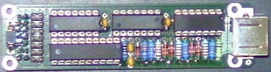

For interfacing a PS/2 keyboard to a 6522, I'm using this here:
Basically two 74164 shift registers for serial/parallel conversion,
and a 74HC14 based retriggerable monoflop which recognizes the end
of the data transmission from the keyboard and latches the data
from the shift registers into a 74574.
...had no 74595 in the drawer, sorry.
Wanted to have a simple interface without using a microcontroller.
Downside is, that it isn't possible to write data to the PS/2
keyboard for changing repeat rate, turning on/off the LEDs etc.
I plugged the module to port A of the 6522 at 0x7F5x,
a rising edge on CA1 indicates that a valid Byte
which was sent from the keyboard is at PA7..0.

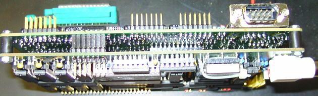

DRC2 (single board computer) and D04 (CRT/LCD controller)
are mounted together as a "sandwich":
D04 can display monochrome 40*25 text,
and 320*200 graphics (similar to the C64 HIRES format).
It also can display both things simultaneously,
mixed together by 7486 XOR gates.
// note: 7486 (XOR gates) and 7432 (OR gates) have identical pinout.

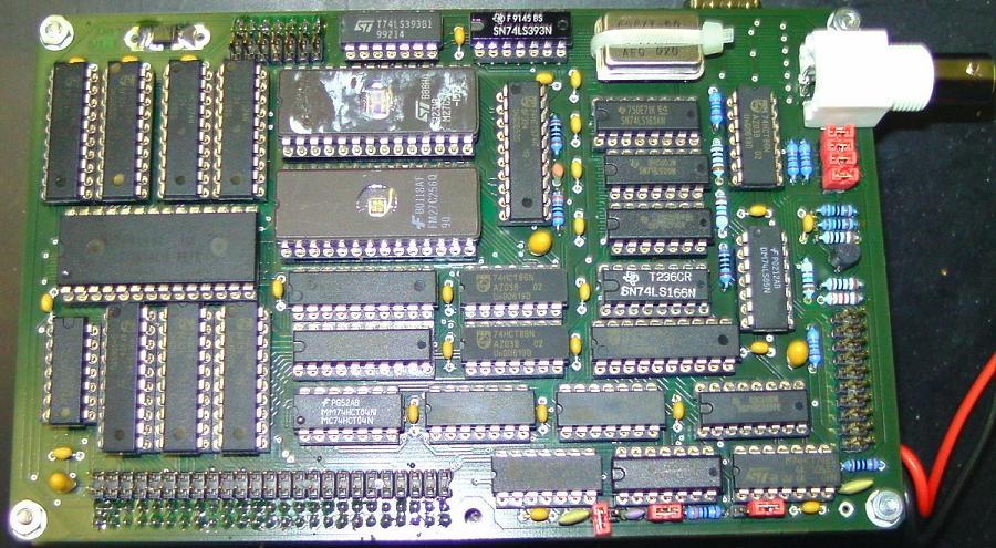

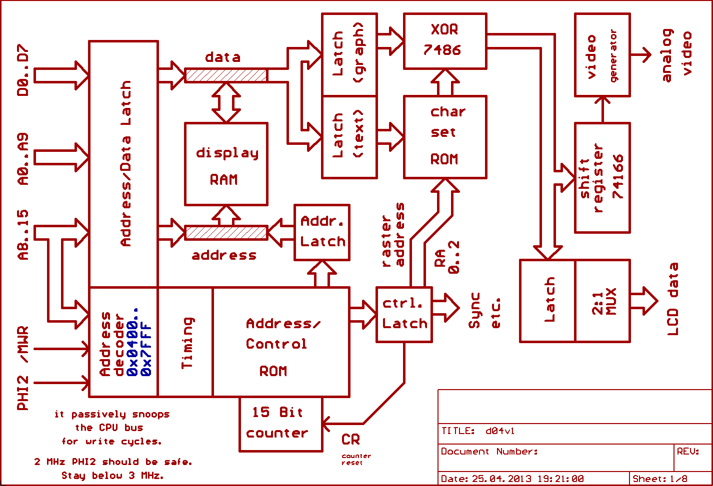

D04, the CRT/LCD controller PCB:
It can drive a CRT and a 320*240 LCD in parallel
(at least in theory). 50 Hz vertical sync.
D04 "snoops" the 6502 bus for write cycles to 0x0400..0x7fff,
holds address and data in 74574 latches, and performs one write
cycle per microsecond into its own display memory.
So the CPU RAM is "mirrored" into the CRT RAM.
The advantage of this approach is, that D04 runs independent
from the CPU with its own clock generator.
During the test runs, it worked with CPU speeds up to 4 MHz,
but I would not recommend to go beyound 2 MHz to be on the safe side.
// For instance, STA ABS has 3 read cycles, one write cycle.
For generating display memory adress and sync/control signals,
I'm using a 15 Bit counter (2 * 74393), plus a 27512 EPROM
which contains a lookup table.
I'm using port B of the 6522 at 0x7F5x to configurate the
CRT/LCD controller: selecting which 1 kB text page is displayed,
turning on/off graphics, selecting an 8 kB graphics page, etc.
There wasn't enough PCB space left to integrate a 74273 etc.
into D04 for doing this, sorry.
PB4..PB0: selects the text     page to be displayed (32 pages, 1 kB each)
PB6..PB5: selects the graphics page to be displayed ( 4 pages, 8 kB each)
PB7     : = 0 enables graphics (default: 1)
CB1     : senses the 50 Hz vertical sync of the CRT/LCD controller
CB2     : switches the character set to be displayed (default: 1)
