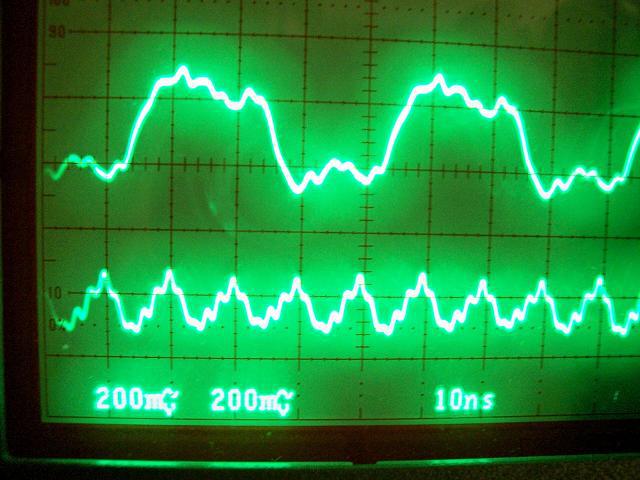

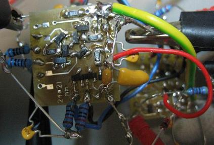

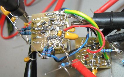

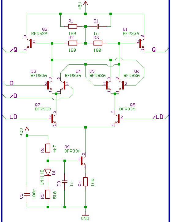

Pictures from a 15 MHz test run with BFR93A transistors.
Had to terminate the flipflop outputs with 100 Ohm resistors to -1.8V,
to prevent the flipflops from turning into oscillators.
Right side: single ended ECL (SECL) to differential ECL level (DECL) converter.
Left side: two transparent DECL latches, wired up as a master/slave flipflop.
Imagine a half 74F74, with !Q connected to D, working as a 1 Bit binary counter
dividing the clock frequency by two.

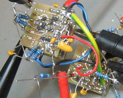

Some more pictures:

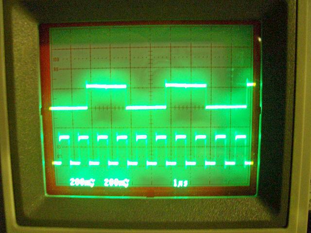

Decided to buy a 100MHz TTL crystal oscillator, and to connect it to the
SECL to DECL level converter by using a capacitive voltage divider.
Please don't take too much attention to signal shape/amplitude and such.
I only had a cheap 200 MHz oscilloscope and lousy 100 MHz passive probes.
But fact is, that it did divide 100 MHz by two, and that the speed is more limited
by wiring, PCB layout and test equipment, than by the transistors themselves.

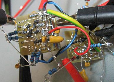

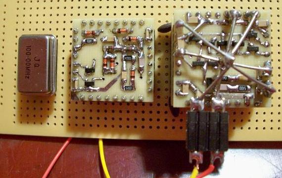

More than a year later, experiments looked like this:
Left: 100 MHz TTL oscillator.
Middle: TTL to DECL level converter.
Right: four transparent DECL latches.

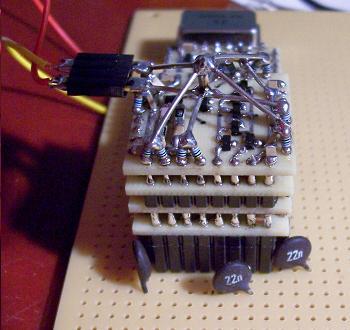

Now for the module on the right:

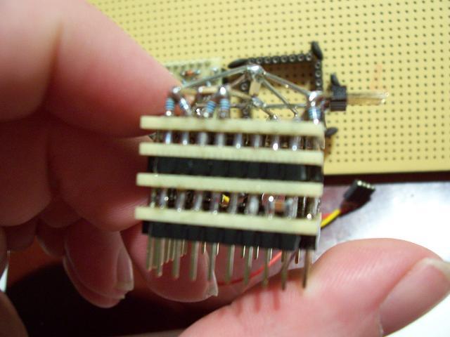

Yep, 4 identical PCBs, rotated in 90 degree steps
and soldered together to a "tower".
The breadboard PCB connects the 4 latches together
to make them work as two master/slave flipflops,
dividing a frequency by 4.
Looks like half an inch of "open" wire makes a difference,
had to place termination resistors on top of the module,
and there also are termination resistors at the bottom
of the "backplane" PCB.
BTW: Tektronix 2467B.

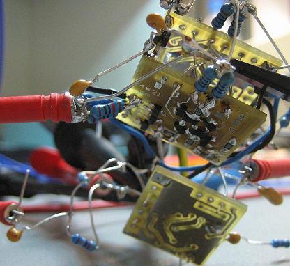

I'm not happy with the PCB layout of the flipflops,
looks like something tries to oscillate in there.
The concept/schematic is a bit different from what I
had back in 2006, and the flipflops are now powered
with +5.0V instead of -5.2V.
Unfortunately, changing the supply voltage happened
a bit late during the design process, and because of this
the TTL/ECL and ECL/TTL level converters are prototypes
which don't work reliable.
