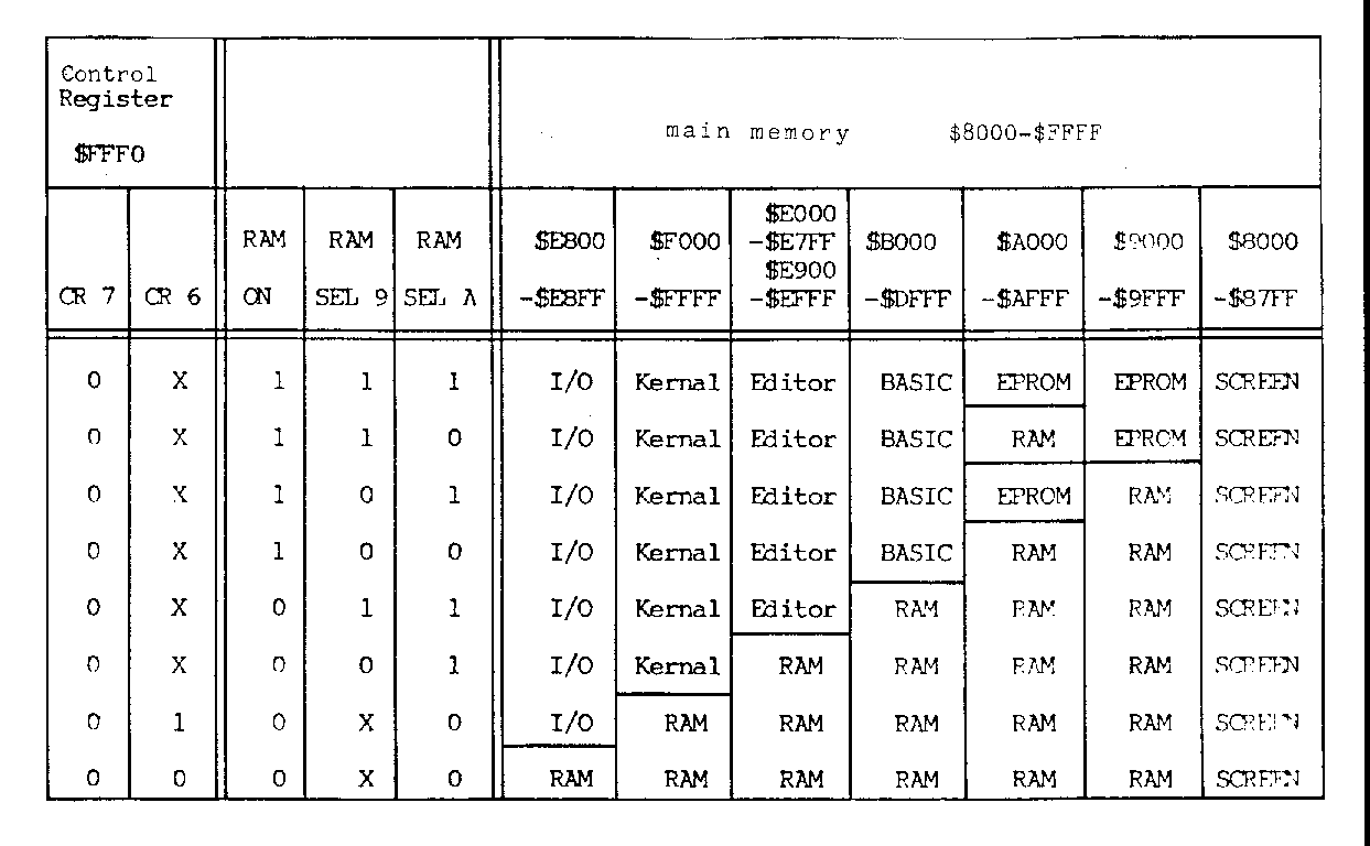

[scanned image] 0 +----------------+ 0000 | | | | | | | | | | | | | | | | 16K +----------------+ 4000 | | | | | | | | | | | | | | | | 32K +----------------+ 8000 ............. +--------------+ +--------------+ | Screen | | | | | +----------------+ 9000 | | | | | | ADDRESSES | BLOCK 0 | | BLOCK 1 | | | 8000 TO BFFF | 16K | | 16K | | | (32K TO 48K) | | | | | | | | | | | | BFFF | | | | 48K +----------------+ C000 ............. +--------------+ +--------------+ | | | | | | +----------------+ | | | | | | ADDRESSES | BLOCK 2 | | BLOCK 3 | 58K +----------------+ C000 TO FFFF | 16K | | 16K | | | E800 (48K TO 64K) | | | | 60K |......I/O.......| F000 | | | | | | FFFF | | | | 64K +----------------+ +--------------+ +--------------+ Figure 2-1. Expansion memory mapping - 2 -
2.2 Control Register Control of the expansion memory is through a memory control register located at address $FFF0. The memory control register provides selection of 16k-byte blocks, write protection, enabling the expansion memory, I/O peek through and screen peek through. Because the memory control register is write only, a copy of the register should be kept in the lower 32k of main memory. Figure 2-2 depicts the functions of the memory control register. The paragraphs following it describe these functions in detail. Address $FFF0 --------------------------------------------------- 7 6 5 4 3 2 1 0 --------------------------------------------------- | | | | | | | | | | | | Enable --+ | | | | +-- Write Protect | | | | $8000 - $BFFF | | | | I/O peek through+ | | Select +--------- Write Protect $E800-$EFFF | | 16K $C000 - $FFFF | | Block: 0 0: 2 and 0 Screen peek through ---+ | 0 1: 2 and 1 $8000-$8FFF | 1 0: 3 and 0 | 1 1: 3 and 1 Reserved ---------------------+ Figure 2-2. Expansion Memory Control Register Control Register Bit 7 - When equal to 1, enables the expansion memory. When bit 7 equal to 0, expansion memory is disabled. Bit 7 defaults to 0 on power up. Control Register Bit 6 - When equal to 1, I/O peek through is enabled. Control Register Bit 5 - When equal to 1, screen peek through is enabled. Control Register Bit 4 - Reserved. Control Register Bit 3 - When equal to 1, block 3 (16k-byte) is selected. When equal to 0, block 2 (16k-byte) is selected. Control Register Bit 2 - When equal to 1, block 1 (16k-byte) is selected. When equal to 0, block 0 (16k-byte) is selected. Control Register Bit 1 - When equal to 1, addresses $C000 through $FFFF on the /Expansion Memory Board only/ are write protected. I/O is not write protected if I/O peek through is enabled. When equal to 0, the addresses are not write protected. Control Register Bit 0 - When equal to 1, addresses $8000 through $BFFF on the /Expansion Memory Board only/ are write protected. The screen is not write protected if screen peek through is enabled. When equal to 0, the addresses are not write protected. - 3 -
2.3. Modifications to the main memory system By contrast with the CBM 8032, each address in the 64 k main memory is covered by RAM. A write command into any address (apart from I/O) causes the corresponding RAM address to be written at, and a read command reads from RAM between $0000 and $8FFF; above $9000 from the empty [EP]ROM sockets, from the ROM or from the I/O devices. RAM $0000 - $FFFF Empty socket $9000 - $AFFF ROM $B000 - $FFFF. except $E8XX I/O $E800 - $E8FF The memory system for CPU read accesses can be modified by means of the signals /RAM SEL 9, /RAM SEL A, and /RAM ON (J4, Pins 12, 13, 14) in accordance with the following table: [The first line represents the normal config. In my machine I have jumpered J4 (the expansion bus) pins 12 and 13 to ground which gives me 8K of additional RAM which is not cleared on reset. Ground pins are available in the adjecent row.] [scanned image] [/NO ROM = 1; see page 12 for more cases] +-----+--------+------------+-------------------------------------------------+ | |Control | | | | |Register| | main memory $8000 - $FFFF [UB1-UB8] | | | | | [$0000 - $7FFF is always RAM from UB1-UB8] | | |$FFF0 | | | +-----+--------+------------+-------------------------------------------------+ | | I/O |___ ___ ___ | E000 | | ___ | peek|RAM RAM RAM | E800 F000 -E7FF B000 A000 9000 8000 | | NO_ | thr.|___ ___ ___ | E900 | | ROM |CR7 CR6 |ON S.9 S.A |-E8FF -FFFF -EFFF -DFFF -AFFF -9FFF -8FFF | +-----+--------+------------+-------------------------------------------------+ | | | | | | 1 | 0 X | 1 1 1 | I/O Kernal Editor BASIC EPROM EPROM SCREEN | | | | | | | 1 | 0 X | 1 1 0 | I/O Kernal Editor BASIC RAM EPROM SCREEN | | | | | +-----+ | | 1 | 0 X | 1 0 1 | I/O Kernal Editor BASIC EPROM RAM SCREEN | | | | | +-----+ | | 1 | 0 X | 1 0 0 | I/O Kernal Editor BASIC RAM RAM SCREEN | | | | | +-----+ | | 1 | 0 X | 0 1 1 | I/O Kernal Editor RAM RAM RAM SCREEN | | | | | +------+ | | 1 | 0 X | 0 0 1 | I/O Kernal RAM RAM RAM RAM SCREEN | | | | | +------+ | | 1 | 0 1 | 0 X 0 | I/O RAM RAM RAM RAM RAM SCREEN | | | | |+----+ | | 1 | 0 0 | 0 X 0 | RAM RAM RAM RAM RAM RAM SCREEN | | | | | | +-----+--------+------------+-------------------------------------------------+ SCREEN: 2000 bytes for screen memory, and 2096 bytes of available RAM. - 4 -

A Memory Map [ I completely rearranged this table. It was printed sideways on the page and repeated earlier info. This would not fit so I omitted the duplicate, presenting only the new mappings in the same form as earlier. ] [scanned image] +-----+--------+------------+-------------------------------------------------+ | |Control | | | | |Register| | main memory $8000 - $FFFF [UB1-UB8] | | | | | [$0000 - $7FFF is always RAM from UB1-UB8] | | |$FFF0 | | | +-----+--------+------------+-------------------------------------------------+ | | I/O |___ ___ ___ | E000 | | ___ | peek|RAM RAM RAM | E800 F000 -E7FF B000 A000 9000 8000 | | NO_ | thr.|___ ___ ___ | E900 | | ROM |CR7 CR6 |ON S.9 S.A |-E8FF -FFFF -EFFF -DFFF -AFFF -9FFF -8FFF | +-----+--------+------------+-------------------------------------------------+ | | | | | | 0 | 0 1 | X X X | I/O Free Free Free Free Free SCREEN | | | | | | | 0 | 0 0 | X X X | RAM Free Free Free Free Free SCREEN | | | | | | | X | 1 X | X X X | 2 x 32 K zus\"atl. RAM from 64K in UA1-UA8. | | | | | | +-----+--------+------------+-------------------------------------------------+ No Rom = 0: marked "for diagnostic". SCREEN: 2000 bytes for screen memory, and 2096 bytes of available RAM. - 12 -

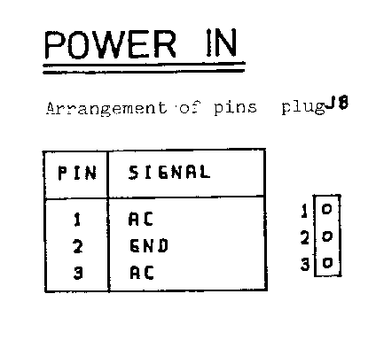

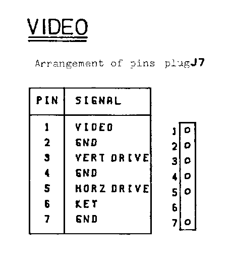

B.1 connectors 8296 IEEE USER - PORT ==== =========== Arrangement of pins plug J1/J12 Arrangement of pins plug J2 +-----+-------------+-----+--------+ +-----+-------------+-----+--------+ | PIN | SIGNAL | PIN | SIGNAL | | PIN | SIGNAL | PIN | SIGNAL | +-----+-------------+-----+--------+ +-----+-------------+-----+--------+ | 1 | DIO 1 | A | DIO 5 | | 1 | GND | A | GND | | 2 | DIO 2 | B | DIO 6 | | 2 | VIDEO | B | CA1 | | 3 | DIO 3 | C | DIO 7 | | 3 | /SRQ IN | C | PA0 | | 4 | DIO 4 | D | DIO 8 | | 4 | /EOI | D | |1 | | 5 | EOI | E | REN | | 5 | DIAG | E | |2 | | 6 | DAV | F | GND | | 6 | #2CASSREAD | F | |3 | | 7 | NRFD | H | | | | 7 | CASSWRITE | H | |4 | | 8 | NDAC | J | | | | 8 | #1CASSREAD | J | |5 | | 9 | IFC | K | | | | 9 | VERT DRIVE | K | |6 | | 10 | SRQ | L | | | | 10 | HORZ DRIVE | L | V7 | | 11 | ATN | M | V | | 11 | GRAPHIC | M | CB2 | | 12 | CHASSIS GND | N | GND | | 12 | GND | N | GND | +-----+-------------+-----+--------+ +-----+-------------+-----+--------+ [ All IEEE signals are active low ] 1 2 3 4 5 6 7 8 9 10 11 12 +--o--o--o--o--o--o--o--o--o--o--o--o--+ | | J1 / J2 [PCB edge connector] +--o--o--o--o--o--o--o--o--o--o--o--o--+ A B C D E F H J K L M N 1 2 3 4 5 6 7 8 9 10 11 12 +------------------------------------+ | o o o o o o o o o o o o | | | J12 [upright pins on PCB] | o o o o o o o o o o o o | +------------------------------------+ A B C D E F H J K L M N CASSETTE 1 CASSETTE 2 ========== ========== Arrangement of pins plug J3 Arrangement of pins plug J6 +-----+-----+----------------------+ +-----+-----+----------------------+ | PIN | PIN | SIGNAL | | PIN | PIN | SIGNAL | +-----+-----+----------------------+ +-----+-----+----------------------+ | 1 | A | GND | | 1 | A | GND | | 2 | B | +5V | | 2 | B | +5V | | 3 | C | CASS MOTOR | | 3 | C | CASS MOTOR | | 4 | D | CASS READ #1| | 4 | D | CASS READ #2| | 5 | E | CASS WRITE | | 5 | E | CASS WRITE | | 6 | F | CASS SWITCH #1| | 6 | F | CASS SWITCH #2| +-----+-----+----------------------+ +-----+-----+----------------------+ 1 2 3 4 5 6 +--o--o--o--o--o--o--+ | | J3 / J6 [card edge connector] +--o--o--o--o--o--o--+ A B C D E F - 13 -
MEMORY - EXPANSION KEYBOARD ================== ======== Arrangement of pins plug J4 Arrangement of pins plug J5 +-----+-----------+-----+--------+ +-----+--------+ | PIN | SIGNAL | PIN | SIGNAL | J4 | PIN | SIGNAL | J5 +-----+-----------+-----+--------+ +-----+--------+ +---+ | 1 | GND | 26 | GND | 25 o o 50 | A | KIN 0 | | o | A | 2 | BD0 | 27 | | | o o | B | | 1 | | o | B | 3 | 1 | 28 | | | o o | C | | 2 | | o | C | 4 | 2 | 29 | | | o o | D | | 3 | | o | D | 5 | 3 | 30 | | | o o | E | | 4 | | o | E | 6 | 4 | 31 | | | o o | F | | 5 | | o | F | 7 | 5 | 32 | | | o o | H | | 6 | | o | H | 8 | 6 | 33 | | | o o | J | V 7 | | o | J | 9 | 7 | 34 | | | o o | 1 | DEC 0 | | o | 1 | 10 | N.C. | 35 | | | o o | 2 | | 1 | | o | 2 | 11 | N.C. | 36 | | | o o | 3 | | 2 | | o | 3 | 12 | /RAMSEL 9 | 37 | | | o o | 4 | | 3 | | o | 4 | 13 | /RAMSEL A | 38 | | | o o | 5 | | 4 | | o | 5 | 14 | /RAMON | 39 | | | o o | 6 | | 5 | | o | 6 | 15 | /SELEXP | 40 | | | o o | 7 | | 6 | | o | 7 | 16 | N.C. | 41 | | | o o | 8 | | 7 | | o | 8 | 17 | /CS 9 | 42 | | | o o | 9 | | 8 | | o | 9 | 18 | /CS A | 43 | | | o o | 10 | V 9 | | o | 10 | 19 | /CS E | 44 | | | o o | 11 | KEY | | | 11 | 20 | /NOROM | 45 | | | o o | 12 | GND | | o | 12 | 21 | /PENSTRB | 46 | | | o o +-----+--------+ +---+ | 22 | /RESET | 47 | | | o o | 23 | READY | 48 | | | o o | 24 | /NMI | 49 | V | o o | 25 | GND | 50 | GND | 1 o o 26 +-----+-----------+-----+--------+ VIDEO POWER IN ===== ======== Arrangement of pins plug J7 Arrangement of pins plug J8 +-----+-----------+ +-----+-----------+ | PIN | SIGNAL | | PIN | SIGNAL | +-----+-----------+ +---+ +-----+-----------+ +---+ | 1 | VIDEO | 1| o | | 1 | AC | 1| o | | 2 | GND | 2| o | | 2 | GND | 2| o | | 3 | VERT DRIVE| 3| o | | 3 | AC | 3| o | | 4 | GND | 4| o | +-----+-----------+ +---+ | 5 | HORZ DRIVE| 5| o | | 6 | KEY | 6| | | 7 | GND | 7| o | +-----+-----------+ +---+ - 14 -
MEMORY - EXPANSION ================== Arrangement of pins plug J9 +-----+-----------+-----+--------+ | PIN | SIGNAL | PIN | SIGNAL | J9 +-----+-----------+-----+--------+ | 1 | GND | 26 | GND | 25 o o 50 | 2 | BA 0 | 27 | | | o o | 3 | 1 | 28 | | | o o | 4 | 2 | 29 | | | o o | 5 | 3 | 30 | | | o o | 6 | 4 | 31 | | | o o | 7 | 5 | 32 | | | o o | 8 | 6 | 33 | | | o o | 9 | 7 | 34 | | | o o | 10 | 8 | 35 | | | o o | 11 | 9 | 36 | | | o o | 12 | 10 | 37 | | | o o | 13 | 11 | 38 | | | o o | 14 | 12 | 39 | | | o o | 15 | 13 | 40 | | | o o | 16 | 14 | 41 | | | o o | 17 | 15 | 42 | | | o o | 18 | SYNC | 43 | | | o o | 19 | /IRQ | 44 | | | o o | 20 | DIAG | 45 | | | o o | 21 | PHI2 | 46 | | | o o | 22 | B R/W | 47 | | | o o | 23 | /B R/W | 48 | | | o o | 24 | N.C | 49 | V | o o | 25 | GND | 50 | GND | 1 o o 26 +-----+-----------+-----+--------+ POWER EXP. AC POWER EXP. DC ============= ============= Arrangement of pins plug J10 Arrangement of pins plug J11 +-----+-----------+ +-----+-----------+ | PIN | SIGNAL | | PIN | SIGNAL | +-----+-----------+ +---+ +-----+-----------+ +---+ | 1 | AC 8V | 1| o | | 1 | +9V UNREG.| 1| o | | 2 | AC 8V | 2| o | | 2 | KEY | 2| | | 3 | GND | 3| o | | 3 | KEY | 3| | | 4 | KEY | 4| | | 4 | +9V UNREG.| 4| o | | 5 | GND | 5| o | | 5 | GND | 5| o | | 6 | AC 8V | 6| o | | 6 | +9V UNREG.| 6| o | | 7 | AC 8V | 7| o | | 7 | GND | 7| o | +-----+-----------+ +---+ +-----+-----------+ +---+ - 15 -
KEYBOARD ======== Arrangement of pins plug J13 +-----+--------+ | PIN | SIGNAL | +-----+--------+ | 1 | KIN 0 | | 2 | | 1 | 13 1 | 3 | | 2 | +---------------------------+ | 4 | | 3 | | o o o o o o o o o o o o o | | 5 | | 4 | \ o o o o o o o o o o o o / | 6 | | 5 | -------------------------- | 7 | | 6 | 25 14 | 8 | V 7 | | 9 | DEC 0 | | 10 | | 1 | | 11 | | 2 | | 12 | | 3 | | 13 | | 4 | | 14 | | 5 | | 15 | | 6 | | 16 | | 7 | | 17 | | 8 | | 18 | V 9 | | 19 | KEY | | 20 | GND | | 21 | N.C. | | 22 | N.C. | | 23 | N.C. | | 24 | N.C. | | 25 | N.C. | +-----+--------+ RESET ===== Arrangement of pins plug J14 +-----+--------+ | PIN | SIGNAL | +-----+--------+ +---+ | 1 | RESET | 1| o | | 2 | GND | 2| o | +-----+--------+ +---+ - 16 -
B.2 Connectors, modifications as compared with 8032 C B M 8 2 9 6 Changes in arrangement of pins J 4 Memory expansion +-----------------------------------+ | Pin Signal | | old new | +-----------------+-----------------+ | 12 /SEL 4 | /RAM SEL 9 | | 13 /SEL 5 | /RAM SEL A | | 14 /SEL 6 | /RAM ON | | 15 /SEL 7 | /SEL EXP | | 16 /SEL 8 | N.C. | | ... | | | 19 /SEL B | /CS E | +-----------------+-----------------+ J 8 Power supply +-----------------+-----------------+ | 8032 | 8096 | | | | | Pin Signal | Pin Signal | +-----------------+-----------------+ | 1 8V AC | 1 AC | | 2 +9V UNREG | 2 GND | | 3 GND | 3 AC | | 4 8V AC | | | 5 8V AC | | | 6 GND | | | 7 KEY | | | 8 14V AC | | | 9 14V AC | | +-----------------+-----------------+ J 10 Power supply for hardware expansion +-----------------------------------+ | Pin Signal | | old new | +-----------------+-----------------+ | 1 -9V UNREG | AC 1 | | 2 -9V UNREG | AC 1 | | 3 KEY | GND | | 4 +16V UNREG| KEY | | 5 +16V UNREG| GND | | 6 GND | AC 2 | | 7 GND | AC 2 | +-----------------+-----------------+ - 17 -
