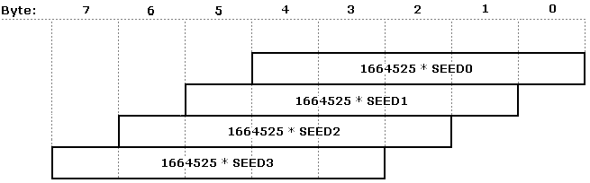

The seed is stored in SEED3 (high byte) through SEED0 (low byte). Putting SEED3 through SEED0 on the zero page will be faster and shorter (i.e. fewer bytes), but it is not necessary.
The fast version works by using four pages of pre-computed tables. There are four 256-byte tables, which are named T3, T2, T1, T0.
T3,X = byte X of T3 = bits 31-24 of 1664525 * X, (X = 0 to 255)
T2,X = byte X of T2 = bits 23-16 of 1664525 * X, (X = 0 to 255)
T1,X = byte X of T1 = bits 15-8  of 1664525 * X, (X = 0 to 255)
T0,X = byte X of T0 = bits 7-0   of 1664525 * X, (X = 0 to 255)
The product of 1664525 * SEED is:
Since only the lowest 4 bytes are kept, the multiplication is: (for brevity, SEED3 to SEED0 are called S3 to S0)
