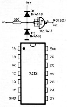

This program employs a seldom-used hardware feature of the 6502. This microprocessor has a SO (Set Overflow) input on pin 38, which can set the Overflow bit in the Processor Status Register externally. On most 6502-based computers, this pin this is available via a connector (RO, pin E-5 on the KIM; SO, pin 14-c on the Junior).
input protection
  The overflow flag is set on the falling edge of the SOV pin, i.e. when the signal on this input goes from high to low. This gives a fast and direct access to the microprocessor without involving the rest of the computer. Once the overflow flag is set, only the software can influence it.
Buffering
Since the measuring is done directly with our circuit, buffering and protection of the SOV-input is necessary. The easyist way to implement this is via a Schmitt-trigger gate, like the 7413. The figure at left also shows voltage and current protection before the 7413. This circuit can measure signals of every shape if the level is around 2.5 V.
