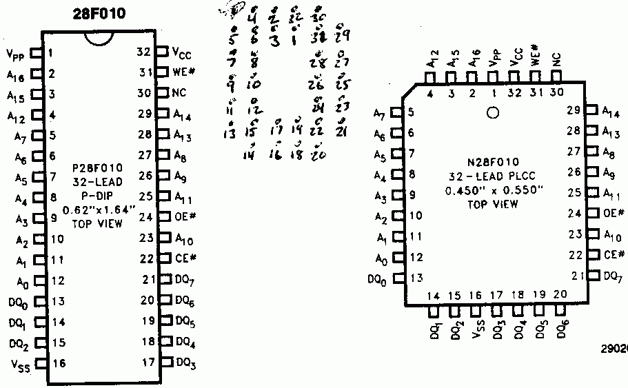

The 28F010 is a 128K X 8 device that can be programmed randomly one byte at a time, but must be erased in it's entirety. Hardware connections to the 6502 are essentially the same as with other 'standard' memory devices.
The 28F010 is available in two different packages, a 32-pin DIP and PLCC.
28f_po.gif - Pinouts for the 28F010 Flash Device.

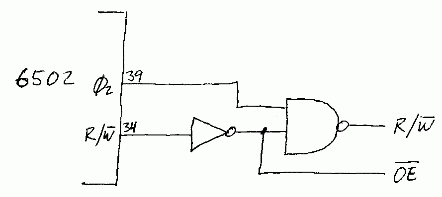

After connecting the power lines, address and data busses, and chip select, you must generate the OE and RW signals needed to talk to memory devices.
oe_rw.gif - Logic to generate /OE and /RW signals.
The method shown is essentially the same as that used on the KIM-1. The CE signal is generated through address selection, the same as with any other I/O or memory device.
Since a 6502 cannot address 128K directly, the upper address bits can be either tied to ground, or controlled from a parallel I/O port (such as a 6522).
Note that the 28F010 requires a +12 volt source on pin 1 (Vpp) during any programming or erasing operation, in addition to the normal +5 volts on pin 32.
