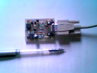

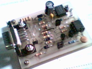

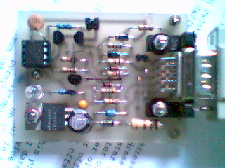

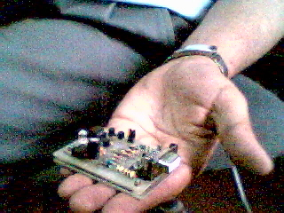

The DPOD board is constructed as a compact card
These photos illustrate the size of DPOD board

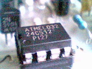

A close-up of the serial EEPROM fitted in DPOD (here ATMEL 24C512)

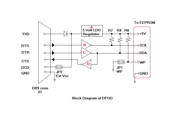

The block diagram of DPOD is shown below:
A DB9 female connector X1 is provided on the DPOD board and handles all interfacing requirements.
When connected to
a PC RS232 port, the TXD line is used to provide +5V regulated power to the
entire circuit (Block A). The open collector inverting buffers (Blocks B and C)
connect to RTS and DTR signals respectively to generate I2C signals SCK and SDA.
The status of the SDA line can be read via the inverting stage (Block D) on the
CTS line. Jumper JP1 when plugged pulls the Write Protect pin (WP pin) of the
EEPROM low to enable writing to the EEPROM. If JP1 is removed, the EEPROM is
partially/fully write protected (see datasheet of relevant EEPROM).
Note that WP, SCK and SDA are pulled up to Vcc through pull up resistors R8,
R7 and R9. These lines are either at logic low level (< 0.4 V) or pulled up
to Vcc. If the power to the circuit is shut off, the voltage on these lines also
falls and never exceeds the Vcc to the EEPROM. Also note that jumper JP2 is not
plugged in this application, but if it is inadvertently left plugged, the DPOD
software merely reads the jumper status at DCD pin and displays it to the user.

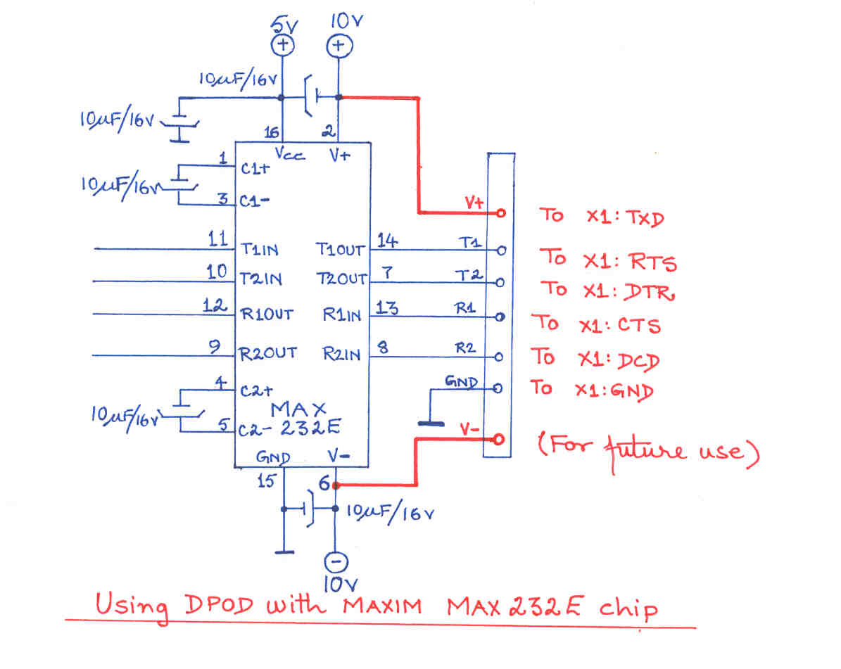

A full serial port is not implemented in many microcomputer boards . My 65C02 microcomputer uses a MAX 232E chip for the serial interface. This chip has two RS 232 output lines while the DPOD board requires three. The following modification (shown in red) needs to be carried out if it is desired to use the same serial port for driving the DPOD board:

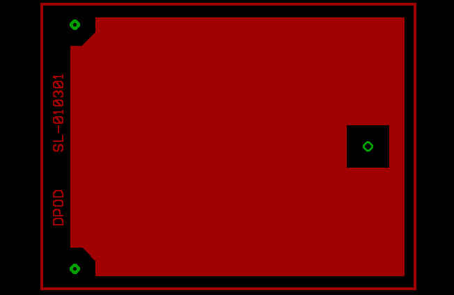

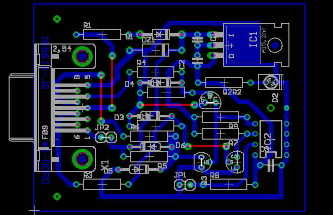

The PCB of the project designed in Eagle Layout Editor measures just 2.6" x 2.0" . A screenshot of the PCB component layout is shown below:
This is a single sided PCB (The red lines are wire jumpers to be soldered on the PCB). A second single sided PCB is designed to serve as a base plate screen which is connected to ground by a short jumper wire. Three holes are provided for 'sandwiching' the two PCBs by means of spacers. The tin plated tracks of both PCBs face each other.
This method of construction ensures that no 'cabinet' needs to be constructed for the DPOD. The photographs given in the beginning of the page may be referred to for an idea of construction details.
The board files for Eagle Layout editor for the top component layout PCB and the base plate PCB may be downloaded from the hyperlinks provided.
After soldering the components on the PCB, the PCBs should be degreased and protected by a thin coat of PCB acrylic lacquer aerosol.

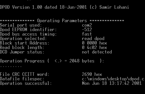

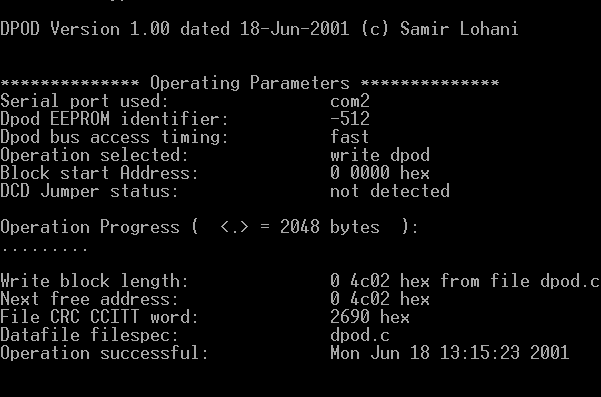

Here are some snapshots of the program output:
Reading file from DPOD and saving in desktop:
dpod -r -l4c02 c:\windows\desktop\dpod.c
