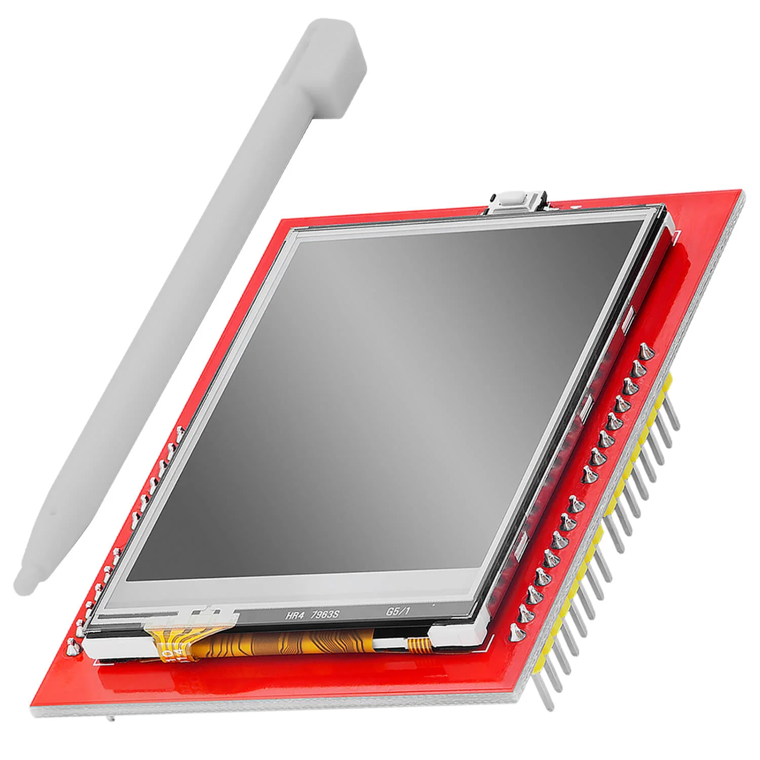

oooh, interesting project idea! i hope you go through with this one.
i've had a similar idea a while back, using one of these cheap TFT shields designed to directly plug onto an Arduino (most of which use the same controller as the DT028BTFT you mentioned):
320x240 @ 16-bit or 18-bit color with an 8-bit parallel interface (instead of SPI like they usually have), plus a built in touchscreen and µSD card slot.
so all you need is a CPU, some RAM, ROM, and logic to combine everything and you'd have a complete self contained system that (besides a µSD card and power) doesn't require any external connections like a keyboard or UART to function. though of course that does require some software to take care of user input, the display, and a file system.
then you just need a battery setup with a protection/charging circuit and you would have the worst DIY smartphone in the world! :wink:
but i've shelved that project for now because i did a bit more digging about these shields and found that while they boast both 3.3V and 5V operation, they will not function without a 5V supply and only the LCD controller has some level shifters, and while the µSD slot does get it's 3.3V from the onboard regulator, the data lines are directly connected to the pins on the side, so on a regular 5V arduino using a µSD card with this for a long time will likely damage the card.
so overall don't buy these if you plan on using the µSD slot.
but the overall idea is not dead. you could still try something similar by just using Adafruit's variant of the board. while it's obviously a lot more expensive, it's also much higher quality and larger, leaving more PCB space for the board that it would plug into, plus it has proper level shifting and it does actually work with only 3.3V power and IO. (which i'd recommend anyways if you plan to go battery powered).
running everything at 3.3V would also give you the chance to just go with an FPGA like a MachXO2 which are relatively affordable.
i know you said you wanted to avoid an FPGA, but honestly i don't thnk a 65816 can feed the LCD data fast enough for a usable framerate...
let's just do some math:
If set the display to 16-bit color mode, every pixel needs 2 Bytes of data. so for 320x240 that's 150 kB which need to be send within ~16.6ms to achive 60 FPS. (assuming the worst case where each pixel needs to be updated).
that works out to ~108ns per Byte (or 216ns for 30 FPS), the controller has a write cycle of 60ns so it could in theory be possible, but definitely not if the CPU does it manually (even at +20MHz).
so using an FPGA to implement some hardware acceleration, like a DMA controller/Blitter, will help the CPU out massively.
you could go a step further and have the CPU work with 8-bit color and have the DMAC convert the 8-bit color to 16-bits before sending it to the LCD using an internal look up table or similar. this would obviously lower the total colors from 65k to 256, but would make operations like copying and blitting twice as fast while also reducing the memory footprint.
welcome to hardware design, where every decision is a trade-off! :lol:
anyways hope you continue this project and keep us updated!

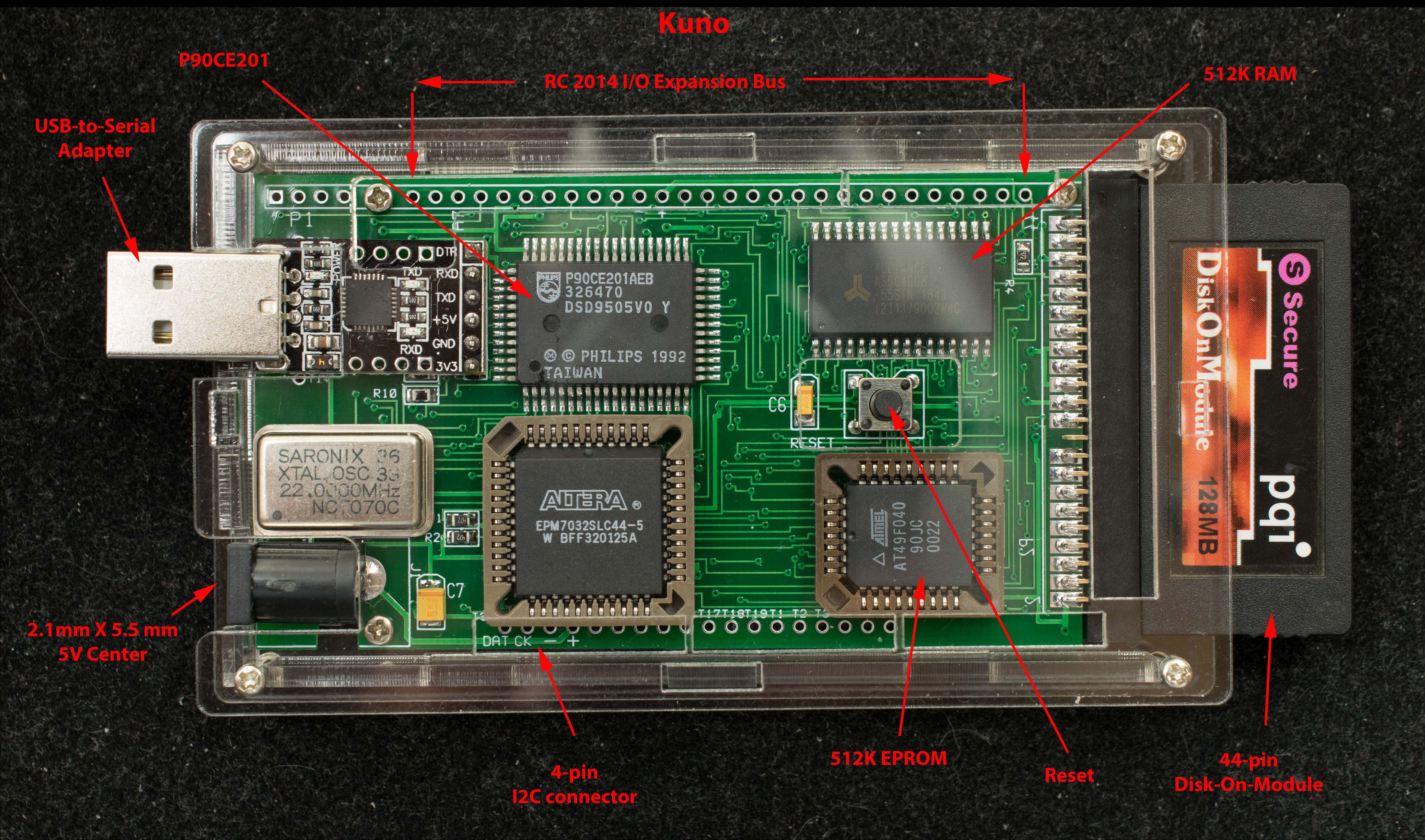

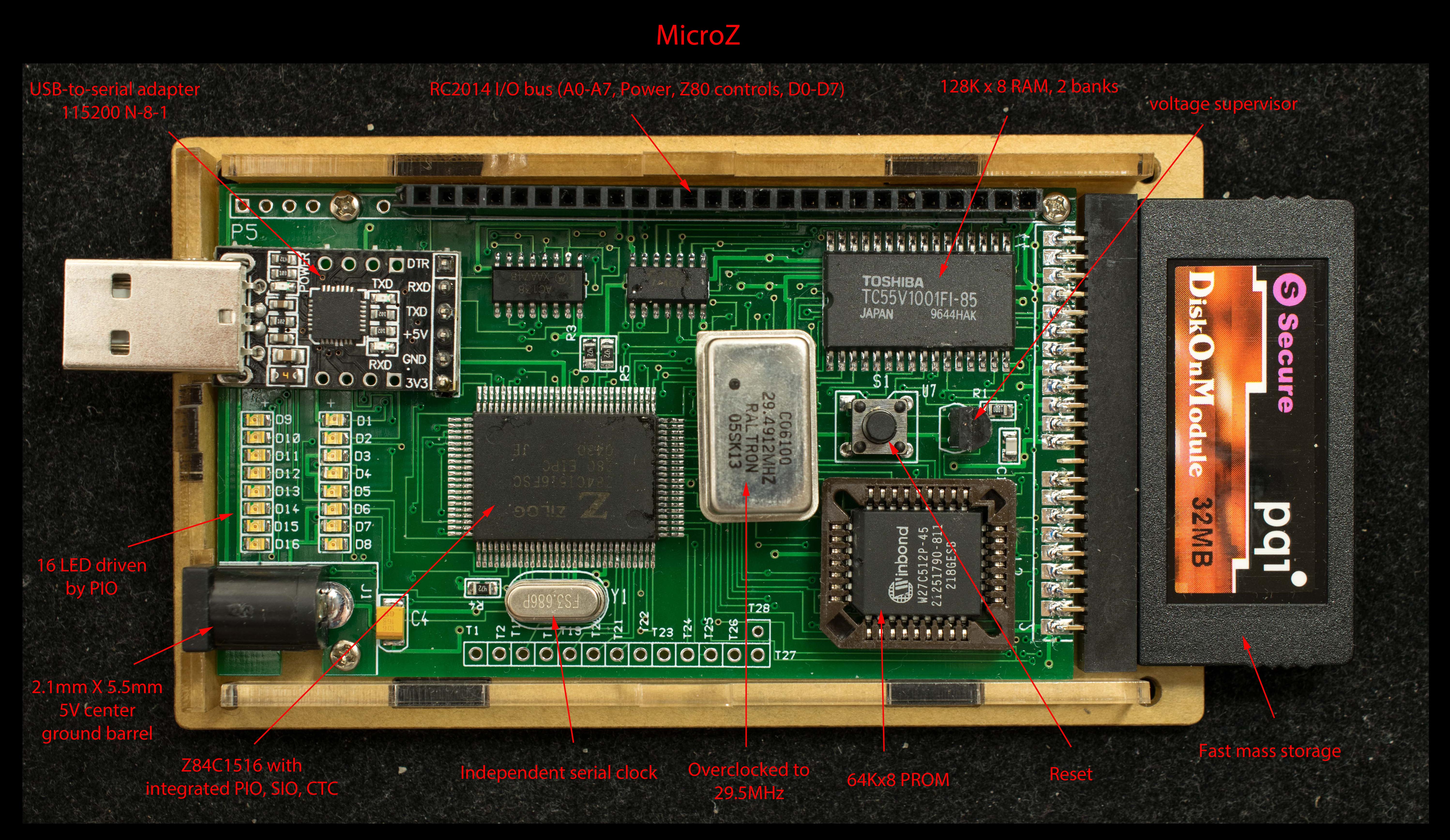

I've been playing with similar idea but with 68000 or Z80 which are significantly slower than 6502 at the same clock cycle. Here are a couple designs for Arduino mega2560 enclosure.
6502 can run reliably to 25MHz. With the help of CPLD, 25MHz 6502 with 512KB RAM and CF disk can fit easily in an Arduino enclosure. Add a 320x240 QVGA display shield, you'll have all 5V, small, compact, and inexpensive unit without using FPGA. I think it is very realistic goal. Go for it!

getting a system with a display like that running without an FPGA (or even CPLD) is not an issue, i mean the interface is almost the same as for a character LCD.
but since it seems that Ardis aims for pretty high refresh rates it would require a bit more horse power to pull off, even with a speedy CPU.
and i guess you're right that they could just go for it. no reason to aim for perfection on the first try. how about just getting a 65816 system running on a breadboard in the first place, then adding one of those shields with a bunch of wires (or an adapter board), and then go full PCB. maybe mess around with some GALs or CPLDs as well. just one step at a time.
on a side note,
one thing i also didn't mention is that while the cheap shields have no level shifting for the µSD card slot, you can sort of use it with 5V by using open collector oputputs for SS, SCK, and MOSI, with 3.3V pull ups on them. which can be "faked" using a VIA (or any chip with programmable IO) and some diodes facing towards the VIA pins.
the diodes make it so that when the VIA drives the pin low it gets pulled low on the µSD card, but when it drives the pin high it's like high-Z on the other side, so the pull-up drive the µSD card pin to 3.3V. or you could just use a uni-directional level shifter IC...
the MISO lines requires no level shifting, even though 3.3V is technically too low for 65xx chips to recognize at 5V, in my experience it works perfectly fine and i think it's just another case of the 65xx datasheets being a bit too pessimistic.

Can the SPI interface handle 320x240 with 16-bit color at 60 frames per second? If so, I'd rather use that than the 18-bit parallel RGB LCD I'm currently using.
nope, sadly not. SPI is way too slow for that.
the Datasheet for the ILI9341 mentions that the maximum speed of the SPI interface is 10MHz, so transferring a whole frame of data will take ~122.8ms (~8 FPS).
when it comes to graphics you just need large bandwidths which means wide data buses or very high transfer speeds.
so like said if you want to actually get 60 FPS you have to use atleast the 8-bit parallel interface at pretty high speeds, or the 16/18-bit one at half the speed of the 8-bit interface.
