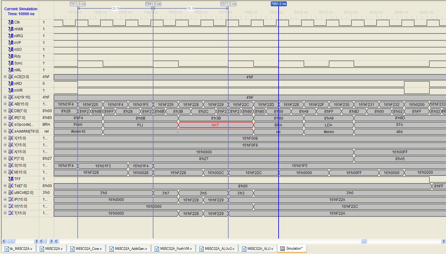

It's been a long time in coming, but I've finally begun testing the Forth VM support I've included in the M65C02A core. The following diagram shows the execution of two M65C02A FORTH instructions which can be used to implement a DTC FORTH EXE or EXIT functions. This functionality is implemented using a 16-bit pull instruction, PLI, and a 3-cycle NeXT instruction. :D
File comment: Forth VM PLI NXT instructions
The test code is a simple DTC FORTH-like Word code sequence where the code field address is populated by the 65C02 BRA rel instruction, so it's only two bytes. The CFA is at address $F22C, and IP is pointing to address $F228.
F222: F428F2                phw #$F228                  ; test DTC EXE
F225: 6B                    pli
F226: 7B                    nxt
F227: DB                    stp
F228: 2CF2                  dw  *+4
F22A: 0000                  brk #0
F22C: 8000                  bra *+2
F22E: A9FF                  lda #$FF
F230: 8D0002                sta $200
F233: EA                    nop
Michael A.
PostPosted: Wed Jul 22, 2015 4:02 pm
Posts: 3362
3-cycle Next, eh? :D And pli is handy for popping a value into IP. I see the code snippet tests pil and nxt.
I'm not clear why you began the executable code with the BRA. The following lda and sta seem meaningful as a placeholder to represent hypothetical user code. But why the BRA? Does it assist with testing?
cheers,
Jef

PostPosted: Wed Jul 22, 2015 10:25 pm
Posts: 760
Location: Huntsville, AL
As I've said before, I'm a complete noobie when it comes to Forth. In my attempt to incorporate some special support for FORTH, I decided to use the prefix instructions to support both an ITC and a DTC VM. As such, I followed a model where the parameter field of a primitive or secondary requires two bytes. Therefore, in my test case, I am just retaining the code field as a reminder of where the ITC CFA pointer must be inserted.I simply used the bra *+2 as a two byte place holder for the code field; I kind of like how the machine code representation of that instruction, $80 $00, looks in the instruction stream. :) When I set up the test for the DTC ENTER instruction, the bra *+2 will be replaced with either the single byte (DTC) ent ($7B) instruction.
Both you and Mike are correct in your assessment that a primitive DTC FORTH word could be implemented with machine code in the code field. The two cycles saved by having no code field in a DTC FORTH word probably should be the preferred implementation.
I hope to complete the testing of the FORTH VM support instructions soon: nxt, pli, ini, phi, ent, and lda (ip,I++). The ITC version of the fundamental operations will require the ind prefix instruction: ENTER => ind ent; NEXT => ind nxt; EXE => pli ind nxt; EXIT => pli ind nxt;
The auxiliary stack usage may add another prefix instruction (osx) to the instruction sequences in either a DTC or an ITC implementation. With the osx prefix, the auxiliary stack, accessed using X, can be used for the FORTH VM's Return Stack (RS), and the system stack can be used as the parameter stack (PS).
Michael A.

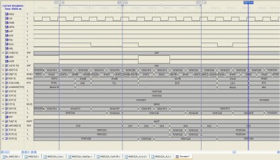

I have tested a number of other instructions: INI, INW (IND INI), PLW (IND PLI), and ENT (ENTER). In the attached figure, I've annotated the PLW instruction followed by the ENT instruction. External behavior are as I expect, and shows that the DTC ENT instruction requires only 5 cycles. :) Only need to verify the ITC mode of the NXT and ENT instructions and the LDA ip,I++ instruction before declaring the ForthVM module tested.
File comment: DTC Forth VM ENTER (DOCOLON)
Edit: removed indirection parentheses around ip,I++ operand. IND, SIZ, ISZ prefixes are supported for this instruction. MAM, 15K15.
Michael A.

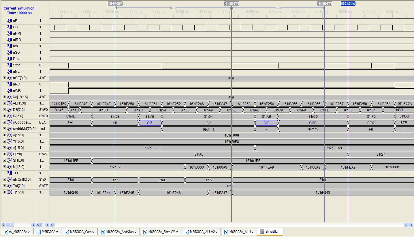

The attached figure shows the LDA ip,I++ Forth VM instruction used to load the accumulator with a 16-bit in-line literal such as used in the LIT and CLIT figFORTH words. The instruction autoincrements IP past the embedded literal/constant so that interpretation can continue seemlessly. Currently, the offset operand is ignored, but can be readily implemented with a simple microcode change rather than a logic change.
Following the LDA ip,I++ instruction is a 16-bit comparison instruction. I've implemented a change to the normal behavior of the CMP/CPX/CPY instructions such that 16-bit comparisons affect the V flag. This change enables the implementation of more powerful conditional branch instructions. PDP11-like signed and unsigned conditional branches will be performed when the normal conditional branch instructions are preceded by the SIZ prefix instruction. I've also set it up such that if the conditional branch instructions are preceded by the ISZ prefix instruction, then the conditional branch is relative to IP. I expect these two simple modifications to significantly improve the efficiency of comparisons for FORTH and standard languages.
File comment: IP-relative LDA with autoincrement
Michael A.
